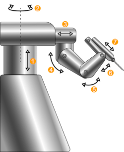

IEC 60601 section 9.8 Table 21 is one of the most referenced tables for medical robot designers. This table defines tensile safety factors that must be incorporated into medical equipment. Let’s look at this table and work through an example to understand how a robotic system designed to apply less than five pounds of force to a patient can rapidly grow into a giant.
Take this simplified cartoon example of a medical robot with 6 degrees of freedom. The first three joints are gantry joints that are stationary while the system is operating. These typically only move at the beginning and end of an operation for setup and tear down. Joints 4, 5 and 6 are rotary joints that manipulate the orientation of the end effector during operation. Lastly, the 7th axis is linear and controls the depth of a drill.
If your goal is to reduce the weight of your system, start your work at the most distal joint (near the end effector), joint 7 in our example. This joint could be driven by a lead screw or belt drive. Belt drives are common in medical systems as they allow heavy actuators to be located more proximal to the robot’s body. This keeps the arms and end effectors of these systems slimmer and lighter which creates more space around the patient.
Let’s reference the table to determine the factor of safety required for a belt-driven linear axis at the end of a surgical robot’s arm. The belt is a “support system part impaired by wear” and in this example, there is “no mechanical protective device” such as a brake. The designer didn’t include a brake because there simply are no linear brakes small enough to operate in this joint. Let’s assume the belt is ductile and experiences elongation of more than 5% at break. This scenario places us in row 3 of Table 1. If we don’t have the dynamic loading of the system well defined, we have to look at column B for the minimum acceptable tensile safety factor. This requires our belt to have a factor of safety (FOS) of 8.
This FOS directly translates into weight because the best way to improve the FOS of a belt is to increase its width. A wider belt requires wider pulleys, requiring wider robotic linkages, wider housings and so on. Weight is typically proportional to width. The path to dramatically reducing the weight of a medical robot is through reducing the FOS required for belts and other drive and support structures.
Including an emergency brake halves the FOS required for the belt system. A brake is a “mechanical protective device” which shifts our cell from row 3 to row 5 and reduces the FOS from 8 to 4! This often translates to a linkage that is half as wide and therefore half as heavy. (Stick with this article to the end to see how brakes can further reduce the required FOS to 2.5)
Adding a brake to a belt-driven drive can reduce the weight of a link dramatically, and the weight of a multi-degree of freedom system exponentially. Surgical systems, cobots and industrial arms all suffer from the same pain point: leverage. The weight of end effectors and distal links act across great leverage and as such, require large, heavy structures at the base to support them. Larger tools require a larger wrist, larger wrist requires a larger elbow, a larger elbow requires a larger shoulder, and so on and so forth.
Each of these structures can have substantial required factors of safety further ballooning their size. This is how a surgical system designed to apply less than 5 lb of force can end up weighing 1,000 lb! Reducing the weight of the most distal joints can have dramatic cascading effects along the arm all the way to the base of the robot. Meaning small savings near the end add up to huge savings overall.

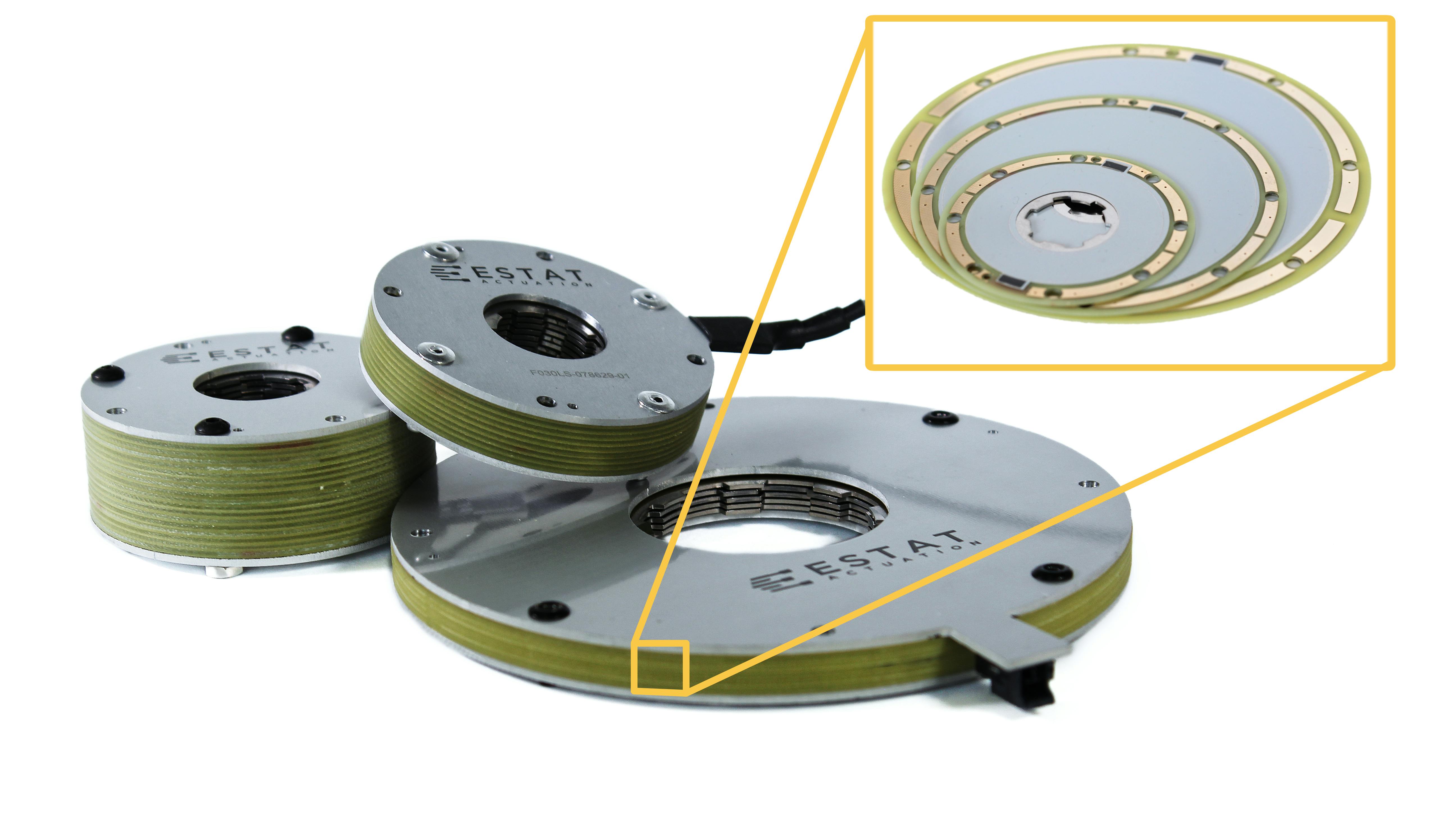

Electroadhesive brakes are a new type of robotic brake that addresses each of these “ifs” well. Electroadhesive brakes are the lightest electrically controllable brakes available. Electroadhesive brakes act like an electric glue. Instead of clamping and releasing a rotor, they stick and unstick to the rotor using static voltage fields. In other words, they lock and unlock using 1,000× less power than magnetic options with components that can be paper-thin.
They are exceptionally well-suited to the task of providing redundant safety for enabling weight reduction due to their small size, negligible power consumption, cool-to-the-touch operation and are magnetically transparent (no ferrous materials and negligible EMI). These brakes are made of modules that are 0.8 mm thick. A brake may consist of only one module, or modules may be stacked to increase holding torque linearly.
To help with brake selection, Table 2 summarizes the pros and cons of a few different brake options. It is included to show how electroadhesive brakes stack up against the most common conventional brakes.
In terms of torque density, electroadhesives are competitive with or outperform magnetic friction brakes. Electroadhesive brakes are incredibly lightweight. While pneumatic and hydraulic brakes typically outperform electroadhesive brakes in terms of torque density for high torque applications, they come with the added complexity of compressors, lines and reservoirs, which are not suited to many medical and most mobile applications due to size and noise.
Rotary electroadhesive brakes can be as thin as 0.8 mm and can be up to 10× lighter than conventional options. Electroadhesive linear brakes are even more compact and can be as thin as two pieces of paper (less than 0.35 mm) and weigh mere grams. While these brakes have exceptionally high force density, their holding force is determined by surface area.
This requires a significant footprint to generate large forces. Typical holding force is 1-3 N of force per each square centimeter of footprint between the moving and stationary sides of the brake. The total holding force is dependent on the geometry of the brake and the quality of alignment.
UltraSlim linear brakes can be particularly effective for providing redundancy for linear axes (joints 1, 2 and 7, in our example) as they act directly on the moving load. This means that they count as an emergency brake and will provide protection in the event of a broken ballscrew or belt.
Linear electroadhesive brakes have relatively low holding force compared to magnetic or pneumatic options but fit in spaces that a traditional brake simply cannot. For miniature linear systems there are no other electrically controllable linear brakes on the market. Due to their exceptional thinness, they can be retrofitted to existing systems with little to no redesign.
UltraSlim electroadhesive brakes can enable designers to put brakes almost anywhere. If two pieces of paper fit between the sliding components, an ultraslim brake will fit. While joint 7 is small, joints 1 and 2 feature large flat surfaces on the telescoping elements. These huge surfaces are ready to be wall-papered with ultraslim brakes.
Electroadhesives can turn housings and shells into braking surfaces. They can be used to enhance gravity compensation, provide controllable stiffness across a joint or to act as an emergency brake. Designers are encouraged to get creative and utilize any parallel, flat surfaces for mounting these brakes.
