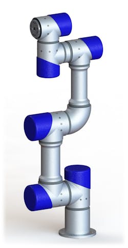

Modular robot joints have emerged as an easy-to-implement way to achieve natural arm motion so a cobot or industrial robot can perform its tasks. They integrate all the essential components into one assembly that occupies less space when compared to a prototyped design. This high level of integration also results in a lightweight unit that is particularly attractive for cobots with lighter payloads. Modular robot joints typically incorporate a frameless motor with a large through-hole to simplify wiring, assembly and installation. Additional benefits include high power density, exceptional dynamic performance and reliability.
READ MORE: Use RDT for Miniature DC Gearmotor Life Projections
A Modular Robot Joint that Eliminates Prototyping Pain Points
Akribis Systems’ ARJ Series is an example of a modular robot joint that eliminates many of the headaches associated with prototyping a robot joint from individual components. It comes with a high-torque direct drive frameless motor with optimized windings to minimize cogging forces, spring engaged friction disk holding brakes to securely hold the robot’s position without backlash, along with integrated EtherCAT Motor drives behind the joints.
The modules also include two 19-bit encoders—one on the load side, and one on the motor side, with a high-stiffness, precision strain wave gear reducer between them. This arrangement allows the controller to calculate the torque acting on the payload in order to provide force sensing and compliance control so the cobot can operate near humans.
READ MORE: Electric Drives, Motors and Components Finalists
This comprehensive yet compact and lightweight assembly allows cobots to support payloads from three to 10 kilograms—depending on the model—and achieve six degrees of arm freedom with smooth motion. Customers can choose a traditional cylindrical housing or a
90-deg. T-mount housing. Specifications include:
  • Five sizes ranging from 70 to 142 millimeters OD.
  • 100:1 (standard) direct drive motor gear reduction ratio with options for 150:1, 50:1 or 30:1 ratios.
  • Weights from 1.2 to 8.3 kilograms.
  • Continuous torque from 12.7 to 248 Newton-meters.
  • Peak torque from 32 to 383 Newton-meters.
  • Accuracy: 200 arcsec.
  • Bi-directional repeatability: 20 arcsec.
Note that the length and weight of the joint depends on the driver option and mounting configuration. Be sure to consult with your supplier before ordering. When ordering, also request they ensure the mounting interface for the base is located close to the load side of the unit in order to minimize the bending moment load.
