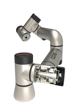

Robotics have infiltrated most industries, including packaging, assembly, machining, medical and many more commercial and industrial applications. The majority of these applications are for small, lightweight systems such as industrial in-line robots, surgical robots and cobots. When designing for such applications, design engineers are tasked to focus on compactness without losing the precision and load-bearing capabilities needed for specific tasks.
These challenges have led manufacturers to consider ways to integrate multiple components into a single installed unit such as robotic joints. Such packaged solutions have allowed for very small footprints, particularly when compared to the alternative that includes a separate motor, gearbox and encoders that must be purchased and mounted together.

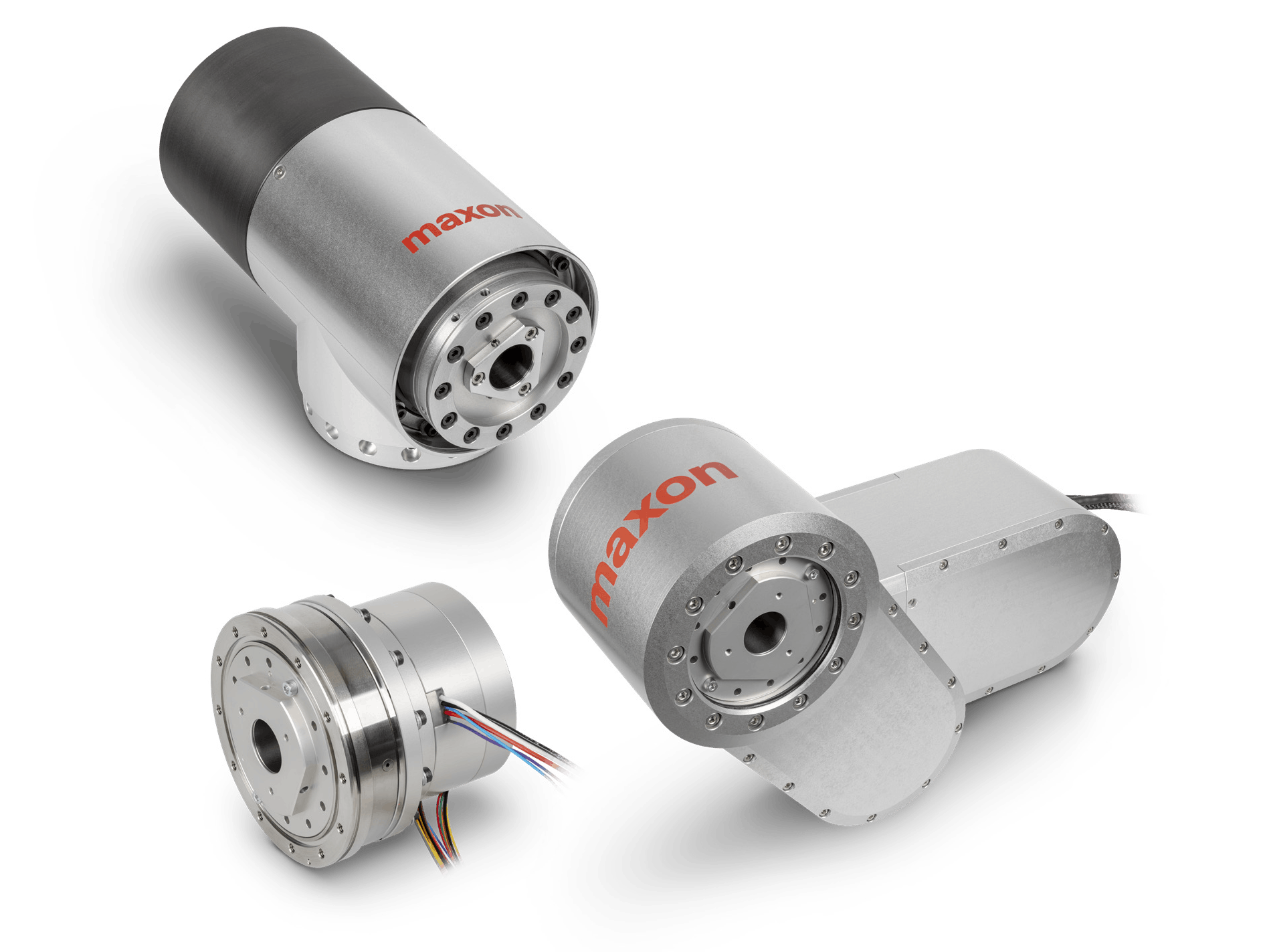

To provide the best possible product for robotic joint systems, maxon has designed and manufactured their high-performance joint (HPJ) line of robotic joint modules. These integrated devices consist of an EC frameless DT motor, a strain wave gear, a motor encoder, an output absolute encoder, an optional braking device and a high-accuracy position controller board.
EC Frameless Motor
Frameless motor components are designed for high-torque applications. Each includes an electromagnetic stator and permanent magnet rotor that operate like a conventional, synchronous motor. These motors are used to drive a high-ratio gear set and possess higher pole counts that are able to increase torque output. Large through-holes allow for optimized packaging, and allow the user to incorporate cameras, sensors or cabling for other devices.
The EC frameless motors offer a very low profile, which makes them ideal for robotic joint applications. The HPJ line of high-performance robotic joints offer nominal output speeds from 10 rpm to 35 rpm to handle a wide range of operations. Maximum possible output speeds based on the use of a 48 VDC supply are in the range of 15 to 65 rpm. The use of a frameless motor in the HPJ line eliminate cogging during slow speeds, which delivers fine, smooth and predictable motion inside the robotic joint system.
maxon’s EC line of brushless motors delivers the performance and long-life capabilities required in the robotics industry. Frameless motors not only offer increased performance in a compact package, but offer more flexibility in shaft and bearing selection when compared to a traditional motor.
