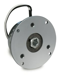

Modified FSBR brakes used in mobile X‑ray machines are just one example of a low-profile electric brake option that’s suitable for applications with minimal space or short motor shaft extensions, according to Regal Rexnord experts. The company has opted to showcase motion systems in medical settings at MD&M West 2026, ranging from surgical robotics and imaging systems to lab automation and powered surgical devices.

Q: For mobile medical equipment where electric brakes are used for parking and holding (not dynamic stopping): What core brake components and specifications matter most, and how do parameters like static torque rating, spring-applied design and power-off operation influence safety and performance?
A: Core brake components include mechanical springs, friction materials and forming and magnet design for optimized performance. Customer specifications and application expertise are extremely important to ensure best selection between available component options.
Our design and test experience with capability to validate different final applications allow product performance selection and our ability to estimate end-of-life product stage without affecting critical safety function of the complete equipment.
Safety also means assessing our product redundancy and SIL rating into customer applications. Brake performance includes high temperature performance, precision with low backlash, reliability with stable static torque and long use with energy dissipation and permissible wear.
Q: For the mobile X-ray application: Space constraints and short motor shaft extensions led to selecting a low-profile, reverse‑mounted brake. What integration challenges do these constraints create, and how do mounting configuration, hub design and custom coil voltage factor into reliable system-level brake performance?
A: Each customer offers different integration constraints, both mechanically and electrically.
For mechanical integration, key challenges are to meet end-of-life performance while providing diameter vs. length best proposal. Our wide product portfolio with different product lines offers the possibility to look at different options with quick prototyping close to the final brake solution.
For electrical integration, key challenges are to reduce brake heating and consumption while ensuring our product life. Our in-house coil design and manufacturing allow us to design different voltages and validate electrical design with final equipment brake control.
Q: Electric brake design trends: How are electric brake designs evolving to support compact, mobile, and safety‑critical applications such as medical imaging—particularly regarding reduced axial length, customization, thermal management and long-term holding reliability?
A: Selecting the right friction options requires balancing between best static performance (such as holding torque) against emergency function (including energy absorption, acceptable wear rates and dynamic torque). Equally important are designs that enable accurate long-term product life.
Electric brake designs are evolving with size reduction between brake axial length and brake diameter, allowing the customer to position the safety brake at their preferred location in the equipment drivetrain. Direct brake integration often offers overall length reduction compared to catalogue motor brake options.
The latest designs also include weight reduction, environmental protection and low consumption, depending on what matters the most for the application.
