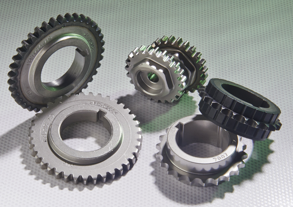

Cloyes Gear
Re-pressing may not be an economic solution, though. The additional processing and energy might reduce the cost benefits of using a PM part. One-way single press and single sintering is improving with selectively densifying areas of critical importance and leaving the core—or non-critical areas—at a lower density. For gears, the critical area is tooth density.
The porosity-induced lack of density kept PM gears from being adopted for high-strength applications until about 15 years ago. By using multiple post-process techniques that have brought densities close to wrought metals, PM is finding its way into some high-cycle, high-strength applications.
Roll densification uses a pressing force and a secondary compaction tool called the master gear, which is rolled into the sintered part. “Capstan was the first company to experiment with roll densification,” says Slattery. “Rolling densification is used specifically to improve the tooth density on a PM gear. Other processes like heat treatments and double compacting/double sintering can improve overall part density. PM gears see such high cycles that increasing the tooth’s surface density will greatly enhance wear resistance. Some high-cycle applications make coatings and plating ineffective. But single-press, high-density, roll-densification-processed gears are able to compete with properties of 8620 wrought steel.”

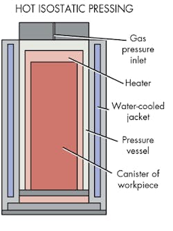

Hot isostatic pressing (HIP) can be used to compact metal powders.

Researchers are continuously developing higher-compressibility powders through alloying. Controlling part density during sintering with time and temperature can expedite sintering while increasing density. Hot isostatic pressing (HIP) can be used to compact metal powders or PM, and metal-injection molding (MIM) can collapse the internal pores to increase density and properties.
