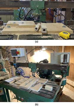

The work is performed substantially by hand, and the operator begins each piece by placing the wooden blank into an older horizontal drilling machine. This machine is hydraulically powered, and originally used limit switches and hardwired relay logic to extend the rotating drill bit a preset distance, then retract it after the drill cycle was completed (Fig. 1).
One problem with this arrangement, other than the fact that it required manual setup adjustments for making different parts, is that when drilling a hole 3 in. or deeper into the wood it is much better to first drill in part of the way, then retract the bit to release the cuttings, and then to repeat this cycle a few times as needed. If not done in this way, the hole may not be drilled cleanly, or there is a chance of scoring the wood in an undesirable manner. The basic machine had no capability to perform a sequence like this, or any variations to improve production.
I was asked to create a small automation system that could perform this sequence and allow easy configuration of the desired number of drilling steps and depths.

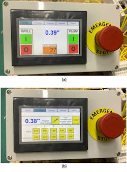

While the control system could have gotten by with a few buttons and lights, an HMI provided the best configurability. The HMI was installed in an accessible location in a small enclosure, with a hardwired emergency stop button (Fig. 3).
The HMI was configured to work in conjunction with the PLC, providing the following display functions:
  • Home: Start/stop buttons for the drill and pump, with an indication of the real-time stroke depth, and a batch cycle counter to help the operator track how many pieces have been made.
  • Presets and Settings: Allows the operator to define up to five unique sets of extend and retract distances and set the “home” position of the drill to calibrate the linear transmitter, as well make other necessary settings.
  • Manual and Status: Allows the operator to manually operate machine functions and check on the operational status, mostly for diagnostics and testing purposes.
