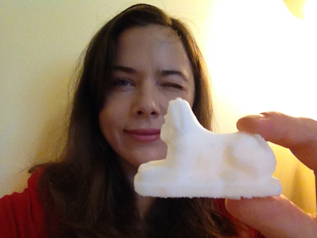

Here's me with the final creation. See the likeness?

Next, I downloaded the Afinia driver to my laptop, took my laptop to the cube where Lindsey set the Afinia up, and connected the laptop to the printer with a normal USB cable. Then I imported the edited .STL file I exported out of Blender into the Afinia software. After checking a few settings, I pressed Print and got this two hours later. Fairly easy, even for a total newbie.
A custom-crafted item with my face on it — a perfect Christmas gift for Mom. They love this kind of stuff.
