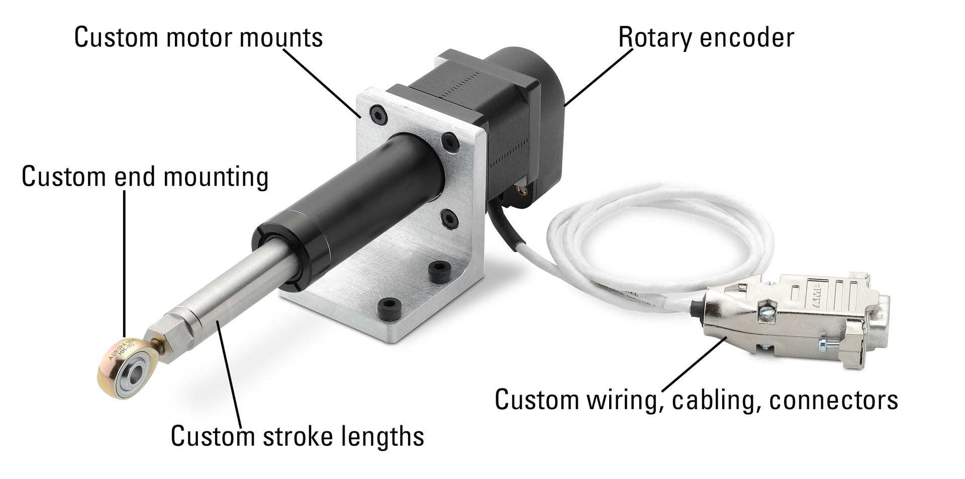

Sometimes all that is needed are some specially machined shafts, connectors, or mounting ends. Here are some examples of linear motion customizations that helped designers fit their parts into irregular spaces, improve ergonomics, or lower costs. Adapting to irregular spaces. The need for customization often emerges after the project begins. For example, a company specializing in customized semi-trailers required several modifications to adapt actuators for use in ramps, stairs, and movable floor assemblies. Fitting ramp actuators in the trailer wall required rotating the motor 90 deg. Next, mounting the actuators in custom ramp frames while still connecting to the standard mounting points meant the company had to extend the actuator tube four inches. Finally, to simplify maintenance, the company retrofitted wiring connections with an easily detachable harness.
Lowering the price. In some cases, the need for customization can be met inexpensively by mixing and matching standard components. For example, a supplier of CNC tubing and pipe bending devices sought help in designing a new machine to meet market demand for a scaled-down version. Their high-end offering used two linear slides bolted together in a cross configuration to control motion on X and Z axes. A stepper motor drove a two-foot ball screw on each axis. The length of the screw required support bearings on both ends and a special coupling to the stepper.
The linear motion component supplier first reduced costs by shortening the shaft to an 11-in. lead screw with a 6-in. drive. This eliminated the need for supports at each end. Using a stepper motor with a built-in motorized lead screw (MLS) reduced the need for external support further because the MLS’s motor bearings could support the load themselves. And because the lead screw and MLS rotor are combined into one part, there was no longer a need to externally couple the screw and rotor.
These are but a few customization examples. The range of options is wide. Companies could also customize stroke and extracted length down to millimeter scale; enhance control by adding encoders; comply with industry regulations by adding certification; select a more aesthetically pleasing finish; implement a custom adapter housing; or improve voltages or clutch handling. Even these are just examples of what can be customized on electric actuators. This same degree of customization applies to shafting, screws, ball bushings, linear guides, and a host of other linear motion components.
