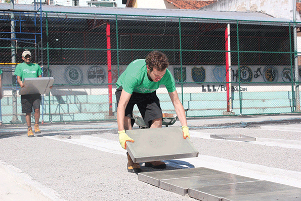

Piezoeletric tiles convert pressure and vibration from people walking on them into electricity to light walkways and fields. (Image courtesy of Pavegen Systems)
The IoT could use piezoelectronics to power electronics. For remote and longer-term sensing and data applications, a battery can lose power and eventually needs to be replaced. A piezoelectric generator, on the other hand, could be without a charge for an extended period. As soon as an outside force acts on it, however, the generator is able to start producing power again. As long as the electronics are still functioning, you can start collecting data again—even if years have passed.
