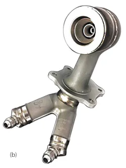

In the same way, GE Aviation, Lafayette, Ind., now prints fuel nozzles for LEAP jet engines at its Cincinnati facility, with direct metal laser melting (DMLM) directly from CAD files. The parts maintain the same material properties and density as traditionally manufactured pieces, but with far more complex geometries. So, they’re 25% lighter and five times stronger than previous nozzles.

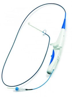

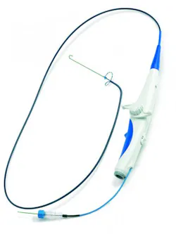

A medical-device manufacturer recently had RedEye print a small lot of catheter parts with redesigned thermoplastic sockets and consoles. Why? The likelihood of design modifications was high, and the company only needed small volumes for foreign clinical trials and (after tweaks) functional tests and a limited-market release.
