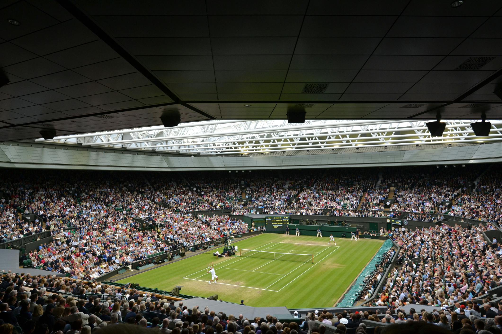

Take the Wimbledon roof; each roof truss would ultimately span about 75 meters with structural resonances starting off at around 1Hz due to the distribution of mass and stiffness. Moog’s digital simulations showed the project team several models for how out of shape the motion control of the trusses could get—ultimately damaging the roof because of the massive amount of force.
System level models are normally digital, which for Whiting means “a digital model that you run offline on a PC or computer.” He adds, “For the Wimbledon roofs, there was also a physical realization of at least part of the system.”
The offline analysis showed there would have been too much risk to rely solely on digital computer modeling. So, the project partners led by Moog settled on a “full-scale model,” of a portion of the roof, including a reduced number of trusses to validate the actuation concepts including axis interaction. Wimbledon accepted Moog’s analysis and risk mitigation proposal.
Moog then constructed a physical test rig in the north of England at a mothballed steel mill to validate the modelled solutions, test algorithms, make decisions and get sign-off on the final design. Part of the modeling relied on the MAST library of reusable modelling assets (e.g., controllers, servo valves, actuators), and in this case electric motors, gearboxes and balls screws.
With the one-two punch of the modeling and a physical test system, Moog proved the roof would work. Wimbledon agreed and ultimately completed construction on the first roof over Centre Court in 2009, followed by a second roof over No. 1 court in 2019.

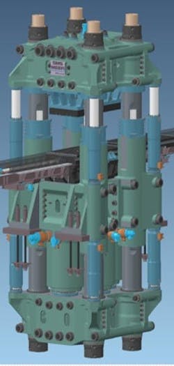

Modeling also played a key role in winning an order to provide valve gear and manifolding for a 50,000-tonne forge press. To achieve such massive die-forging loads at speed, the press’ system return requires the rapid decompression of hydraulic fluid.
Accelerating fluid at low pressure into the press’ return system could have caused significant pipeline damage from cavitation and fluid inertia. These factors are especially difficult to manage for larger pipelines (e.g., up to 300 mm diameter and 50m in length), the type found on the press.
The press maker tapped Moog for help because of the New York-based firm’s range of solutions. For instance, Moog’s work in motorsports can require a servo valve flow rate as low as 0.5 liters per minute; the valves Moog ultimately used for the press had a flow rate of 40,000 liters per minute.
Among the first steps Moog took to solve the press maker’s challenge was using Simulink and MAST. The engineering team modeled the decompression process including the return system physical layout, valve type and algorithms to safely decompress hydraulic fluid in this extreme application.
