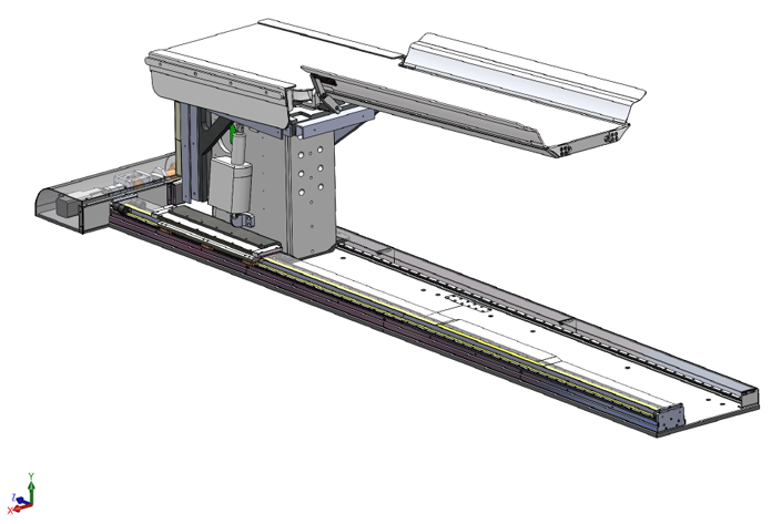

For an example, consider a patient bed in a medical diagnostic system. The unit needed to offer high-speed, precise positioning while being strong enough to hold even very heavy patients without introducing error or increasing settling time. In addition, space constraints required that all electronics be located under the bed.
It is impossible to effectively design this type of system without a multidisciplinary approach. We had to know the size of the motors, the gearboxes, and the other sensors during the mechanical design to ensure that everything would fit and there were no surprises. Because this was a medical device, it had to satisfy redundancy requirements by including dual position sensors.
In addition, these devices need to be included in the CAD model upfront to guarantee that there was enough space and that the system performed to specifications. If we had not planned ahead for the sensors during mechanical design, there would not have been room.
