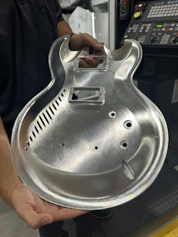

It feels right and the tone is on point, but it is not an average electric guitar, and it wasn’t made the traditional way. This instrument was carved out of 140 lb of solid aluminum using computer-aided manufacturing (CAM) software from Mastercam and computer numerical control (CNC) machining processes. It comes from the house of Dean Zelinsky, a legendary wooden guitar maker whose work is used by the likes of Johnny Depp and Zakk Wylde (of Ozzy Osbourne fame).

Creating a hollowed-out aluminum guitar presented numerous technical challenges, starting with the need for approximately 20 million lines of code to guide the manufacturing process. Achieving the durability of wood without making the guitar excessively heavy was one of the main obstacles; the target was to match the weight of Zelinsky’s Italia guitar, which is approximately 8 lb. To meet this goal, the project’s team used CAM software to generate the extensive code needed, enabling precise control over each detail.
The unprecedented design of the Zelinsky guitar project is composed of just three main pieces, requiring machining technology to overcome design and material challenges. The project utilized Okuma America Corporation’s advanced Super-NURBS settings, which enabled highly accurate and smooth machining paths necessary for creating the guitar’s complex contours.
The project also relied on machining technologies like the SpinJet Micro and MULTI-MASTER T-slot tools from ISCAR Metals. The RockLock system from 5th Axis was used to secure the guitar body during machining, supporting the intricate cuts required for features like vented ramps and a honeycomb structure. The honeycomb design on the guitar’s underside allows it to retain the right balance of durability, weight and resonance.
