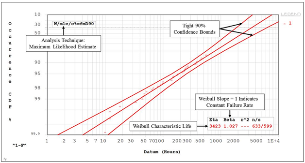

This scenario involves a two-parameter Weibull analysis of a line replicable unit (LRU) on a helicopter. The LRU was not a flight-critical component, so the goal of the analysis was to determine the best replacement interval (results shown in Analysis for Aircraft Problem). By definition, LRUs are not repairable when they are replaced and they often fail due to several causes. As a result, the Weibull plot may show competing failure modes. The other possibility is that a large number of competing failure modes may blend together in the analysis, making it impossible to separate failure modes without more effort and information.
As with the previous examples, MLE was used to perform a two-parameter Weibull analysis. Results show a good correlation between plotted failures and the analysis’ prediction. The high number of failures also yields much tighter confidence bounds. The fact that all plotted failures fall inside the 90% confidence limits is another indication of a good fit to the data.
Related
Weibull Plots Predict System Reliability
Unlocking Weibull Analysis
Calculating Machine Reliability from Bearing Life
The characteristic life, Eta=3,423 hours, was much higher than the customer’s expectations, which helped with the “bad news” about Beta. A Beta value of approximately 1 indicates that LRUs were failing at a constant failure rate. This could be due to a single failure mode or a mix of a large number of failure modes, but separating the data was unlikely with the information available.
A constant failure rate is problematic from a maintenance perspective. As the failure rate does not change with age, newly installed components have the same probability of failing in the next hundred hours of operation as ones that have been running for 1,000 hours. In such cases, proactive maintenance does you no good. This leads to two alternatives; redesign the component if it’s not meeting its reliability requirement, or run the component to failure before replacing it. Fortunately, the LRUs were exceeding their reliability requirement.
