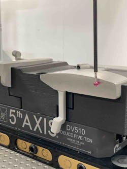

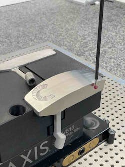

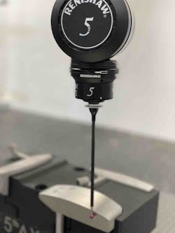

The very last piece of the programming process was to write code for the coordinate measuring machine (CMM) inspection using CCCS’s usual CAM and inspection software. CMM units are sophisticated metrology devices that use probes to measure part geometries in different dimensions. Some CMMs, including CCCS’s, have 5-axis capabilities. They excel in tracking deviations from one surface to another, like when a critical plane must be perpendicular to another to achieve the best bore.

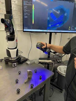

Similar to the handheld probe mentioned in the second article in this series, a CMM creates a point cloud of the part’s surface area. This data is compared to the part’s design intent and original model. The average CMM can relate geometries to within one micron. The program directs the CMM in the best way to take these measurements.

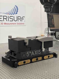

Once the part is machined, and the operator is confident that the part is good, it goes to inspection. CCCS’s CMM is situated within a modular work system, meaning the part had to travel minimal distance from where it was machined to where it was inspected. The CNC machine even held the same plate for mounting the fixture as did the CMM. To conserve time and material, the same soft jaws used to hold the casting were used during CMM inspection. Creating a new workholding device would have tied up a 3D printer, a CNC unit and required extra material.
Creating a Single Perfect Fixture
It is common practice to use two different but adequate workholding tools for machining and inspection, but the CCCS team knew the advantage of creating a single perfect fixture. The different units often must reach different sections of the part in different ways. If the fixturing gets in the way of machining or measuring a critical point, it is useless. When building the fixture, the programmer was mindful of how the fixture was going to behave in both machines. Fortunately, the CAD/CAM software used for CNC programming and simulation could also be used for designing and creating the fixture.

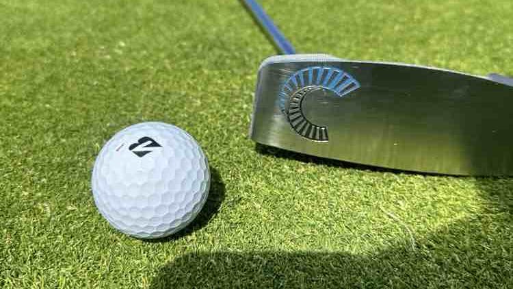

At the end of inspection, manufacturers have a well-made part and its associated data, collated to make process tracking simple. The report will include how the part was made as well as metrics on how it holds to tolerances. In the case of the golf putter, the production team was pleasantly surprised at the end of manufacturing.
Some members had been skeptical of 3D printing a part with a carbon fiber polymer; historically, accurate and resilient parts have mostly been machined. Once the CCCS team members witnessed how additive and subtractive manufacturing worked together, though, they were convinced. This combined approach reduced weight and vibration and gave the team more flexibility.
