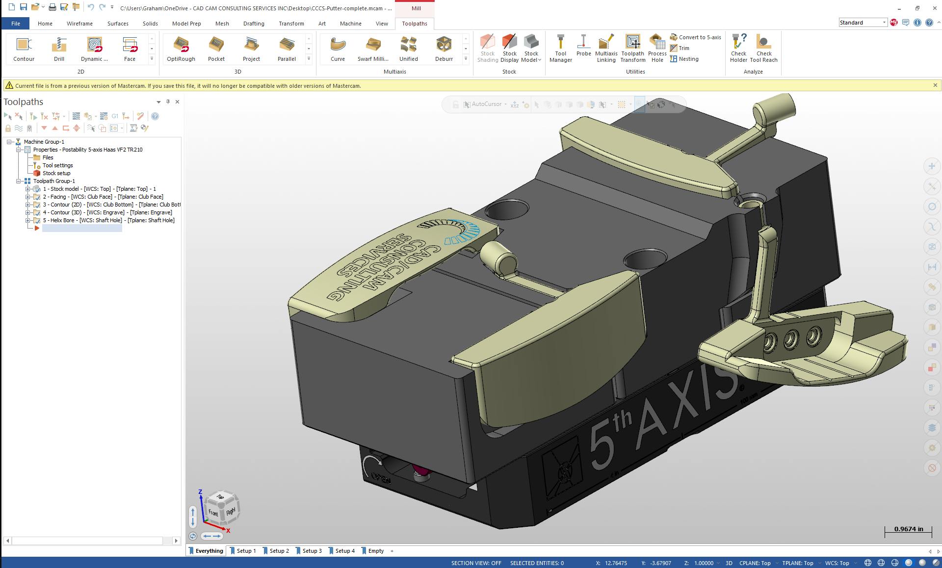

Full golf putter part with fixturing was programmed in CAD/CAM software.

To demonstrate how closed-loop manufacturing can be used by any company, regardless of size, CCCS used one computer and one part file to create and control the entire manufacturing loop from inside CAD/CAM software. The putter was designed using the CAD tools available in CAD/CAM. The tools were used to enhance a solid model, which was needed to create the soft jaws that held the part. Model preparation tools prepared the part for machining in conjunction with the soft jaw design, all within CAD/CAM. The model for the jaws was saved as a stereolithography (STL) file and sent to a 3D printer, which created the carbon polymer product.
While the jaws were being processed, the part casting was still accessible. Using probing software, the technicians were able to locate parts on the machine and a program to find the work offset was written. Everything related to probing was programmed within CAD/CAM, as were several machining toolpaths. Critical features of the casting, in this case holes, were machined using contour, drilling and boring routines.

The CAD/CAM software offered backplot, verify and machine simulation to double check the machining program. Backplot made sure that the tool was cutting where it should, checked for gouges and machine simulation checked for machine kinematics, or how the machine moved. These steps ensured that the CAM program was on spec before it was converted to G-code.
Next, the code was launched in an add-on CNC machine simulation software program through CAD/CAM. With one click of a button, all part and toolpathing information was transferred into the simulation software to run the simulation program, which is the actual G-code and a digital twin of the CNC machine out on the floor. There was no need to manually prove-out NC code. This eliminated the typical dry-run routine.
