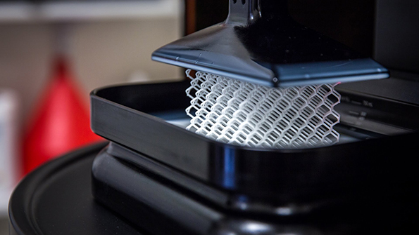

3D printing start-up Carbon (formerly Carbon3D) was recently in the spotlight when it launched its first commercial offerings: a printer, dubbed the M1, and a range of resins for it targeted at prototyping and low-volume manufacturing applications. The M1 uses Carbon’s photopolymer printing process called “continuous liquid interface production” (Clip). It builds parts in a vat of photopolymer resin by shining UV light up through a window in the bottom to expose an entire layer of the part being printed at one time. The company claims its process is up to 100 times faster than other photopolymer printing processes like stereolithography (SLA) and photopolymer inkjet, and also results in materials with anisotropic mechanical properties.

The core advantages of the Carbon system are its speed and ability to build parts without the material layers characteristic of traditional 3D printed parts. The bonds between traditional layers greatly weaken printer parts, reducing their usefulness.
In 2013, Lux Researched called out mechanical performance and build speed as critical issues for 3D printing. So, had Carbon’s M1 come out in 2013, it would have been incredibly disruptive. However, major progress has been made in part strength and print speed in the past three years by groups such as Oak Ridge National Laboratory, Cosine Additive, and Arevo.
Carbon’s published mechanical performance figures, while good, are not disruptive or even best in class. In addition, the M1’s build chamber is relatively high, but quite narrow. This likely indicates that there is difficulty in rapidly flowing viscous resin under the part as printing occurs, which limits the possible size of the build chamber. A wider build chamber would make it much easier to penetrate the tooling market, the second largest and rapidly growing segment for 3D printing.
Moreover, while Carbon’s printer platform is priced to move, its materials are more expensive than alternative materials across nearly every class. On the low end, its prototyping resins are similar in cost to available photopolymers, but these must increasingly compete with thermoplastic polymers for FDM printers, which start at less than $40/kg. On the high end, its cyanate ester resin is more than four times the cost of the carbon fiber-filled polycarbonate used by Cosine Additive ($75/kg), a material that boasts similar mechanical properties and the ability to be used in objects as large as 1 m3. While Carbon’s system does have advantages, most notably in part-surface quality, there are a range of competitive options  that can match it in performance at a lower cost.
What’s more, Carbon’s overall strategy is reminiscent of the razor/blade model that 3D printing majors have long employed. However, potential users of 3D printing for tooling and end parts increasingly demand control over the material formulations they use. Startups such as Cosine Additive give end users this freedom and leverage it as part of their value proposition. Carbon’s decision to restrict the materials used in its printer will further slow growth in functional prototyping and end-use applications. As a result, Carbon is best positioned to compete directly with incumbents such as 3D Systems and Stratasys for the prototyping market, rather than with other emerging startups looking to capture the faster-growing tooling and end-part manufacturing markets.
