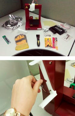

2. Top: The Afinia comes with an array of tools. Bottom: Only the ABS spool holder needs assembly. Attachment with an Allen wrench is quick and easy.

Assembly: Comes fully assembled, sans the spool holder. But the spool holder attaches quickly with an Allen wrench (included).
Tools needed: The Afinia ships with everything a designer needs to print and remove support material. We suggest having super glue handy for reattaching any pieces that break off printed parts. Also, as a safety precaution, we wore safety goggles to protect our eyes from bits of plastic that fly off when removing more stubbornly affixed support material with an X-Acto knife (also included).

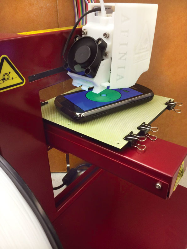

4. We used a smartphone app to get the printer platform level. A level platform prevents the nozzle from scraping and lets the printer make even parts.

• Leveling the platform: If the platform is not level, the print won’t be even. What’s worse, the nozzle can scratch against an unleveled platform, which puts it at risk for damage. To level the platform, don’t eyeball it. Get a level and use the manual screws at each corner to adjust. We used a smartphone with an app called Bubble Level. Placed it on the platform, it told us when we were on target.
