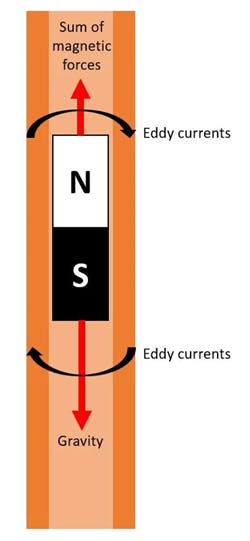

A small experiment can explain this phenomenon. When a magnet is thrown into a slightly ferromagnetic tube—like copper or aluminum—the speed of the falling magnet is much lower than what would be expected.
Why does this happen?
Lenz’s Law states that:
Induced EMF = −Δɸ/Δ𝑡
Δɸ is the rate of change in magnetic flux and Δ𝑡 is the corresponding change in time.
According to Lenz’s law, when the magnet falls through the tube, the changing magnetic field induces current that flows in a direction that opposes the change in the magnetic field that produced it, thereby reducing the magnet’s speed.
