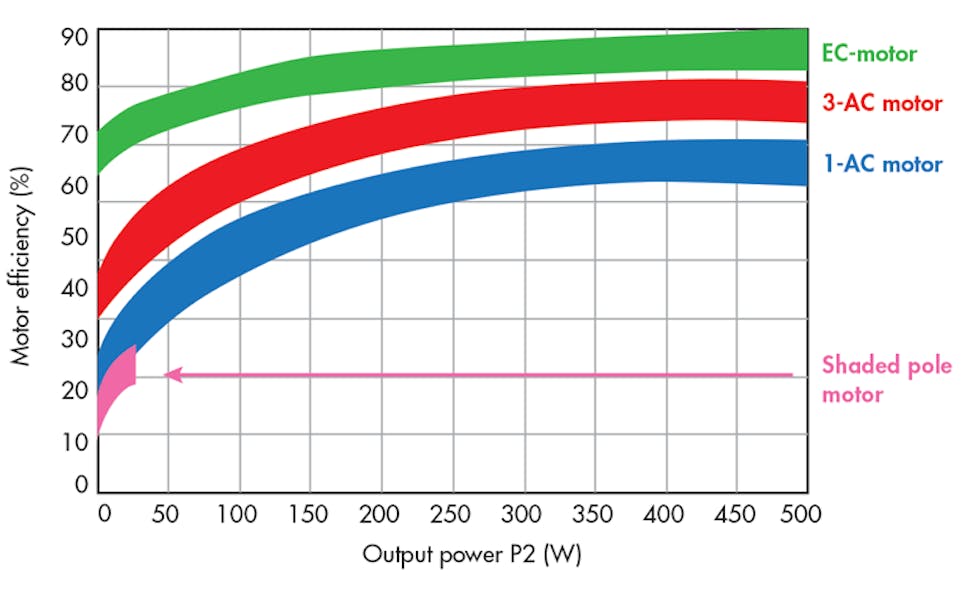

The Efficiency of Electronically Commutated Motors
The chart compares the motor efficiency of an EC motor, three-phase induction AC motor, one-phase AC induction motor, and a shaded pole motor.
EC motors are brushless dc motors controlled by external electronics—either an electronic circuit board or variable-frequency drive. The rotor contains permanent magnets and the stator has a set of fixed windings. The mechanical commutation is performed by the electronic circuitry. The circuit board switches the phases in the fixed windings to keep the motor turning. This supplies the right amount of armature current. When the current is delivered in the right direction at the precise time, the higher the accuracy is achieved. Since the motor’s speed is controlled by external electronics, EC motors do not have a limited synchronous speed.

When comparing efficiency of an EC motor to an AC shaded pole motor or an AC permanent-split capacitor motor, shaded pole motors have an efficiency range of 15 to 25%, permanent-split capacitors (PSC) range from 30 to 50%, and EC motors have an efficiency of 60 to 75%. In a report from the Department of Energy in 2013, EC motors were found to be the most efficient upgrade option for current motor applications.
The report states “The range of efficiency for PSCs is very broad, for example 35-50% in airflow applications, especially when operating at less than full load. EC motors can have a more narrow range of efficiency over different speeds, typically around 70% for motors that have fractional horsepower and above 80% for those at integral horsepower.”
