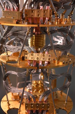

For example, D Wave’s current commercial computer, the D-Wave Two, needs its qubits (or niobium wire loops) to be kept as cold as possible, with as little exposure to thermal noise or thermal vibrations as possible. This translates into –273°C, or 0.02° above absolute zero. To handle that task, it uses a dedicated closed-cycle dilution refrigerator. It consumes much of the 15.5 kW of power needed to run the 512-qubit machine.
Keeping the processors cold minimizes thermal noise—a must for inducing or setting the stage for quantum phenomenon. The processor is also kept in a near-vacuum to eliminate interference with stray molecules. Vacuum is said to be one ten-billionth that of atmospheric pressure.
The processor is also shielded from magnetic fields, a step to prevent the Earth’s magnetic field from interfering with those in the niobium loops. D-Wave Two’s shielding knocks the Earth’s magnetic field down by a factor of 50,000. Engineers also had to construct a way to get 192 lines into the processor and one fiber-optic feed out of it without breaking the magnetic or pressure seals.

The dilution refrigerator takes the processor in the D Wave Two down to 20 millikelvins.
