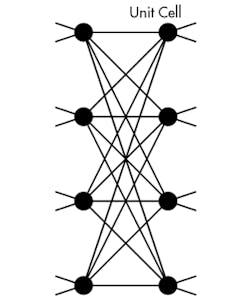

Map a single region to a unit cell
In these diagrams, each vertex represents a qubit and each edge represents a coupler between qubits.
To finish the first step of transforming the map-coloring problem to a QMI, C qubits were introduced for each region in the map and weights and strengths for the qubits and couplers were initialized. The connectivity pattern of the qubits and couplers is represented in the figure Connectivity of Qubits and Couplers. It illustrates how each graph vertex represents a qubit and each edge represents a coupler between qubits. The Unit Cell figure depicts a small portion of the pattern of physical qubits and couplers corresponding to the unit cell. It is easy to find many instances of the complete graph on two vertices, but there are no instances of the complete graph on three or four (or more) vertices. This poses the next challenge.
This figure depicts a small portion of the pattern of physical qubits and couplers in the D-Wave System corresponding to the unit cell.
To solve this problem, make a distinction between logical qubits and couplers and physical qubits and couplers inside the quantum computer. Each logical qubit corresponds (via an embedding) to one or more connected physical qubits, which is called a chain. To implement a coupler between logical qubits, it is enough to find a physical coupler connecting any physical qubit in the chain for the first logical qubit to another physical qubit in the chain for the second logical qubit.
This strategy makes it easy to map complete graphs on up to four vertices to the unit cell in the computer. The chain for the first logical qubit cor­responds to the top two physical qubits in the unit cell. Likewise, the chain for the nth logical qubit corresponds to the two physical qubits in the nth row of the unit cell. It is easy to confirm there is a physical coupler between each pair of chains, yielding a unit-cell embedding for complete graphs of up to four vertices.
To ensure the physical qubits within one chain faithfully represent a single logical qubit, we must define weights and strengths for the physical qubits within a chain that keeps them aligned.
By referring to the table of objective values for the two-qubit system, it is easy to see that assigning a1= 1, a2= 1, and b12= −2 give the aligned chains an objective of 0 and misaligned chains an objective of 1. Note that the weight and strengths necessary to implement this desired set of states are negative versions of the weights and strengths used to solve the “1 of 2” problem.
To complete this step, supply a rule to map weights and strengths for logical qubits and couplers to the physical qubits and couplers that represent them. Each logical qubit is represented by a chain of length two so we divide the weight of -1 for the logical qubit in half and apply a weight of -1/2 to each physical qubit in the chain.
Likewise, we specified a strength of 2 for logical couplers. Because the chains for each pair of logical qubits are connected by two physical couplers, we also divide the logical strength of 2 into two physical strengths of 1 each in the unit cell.
