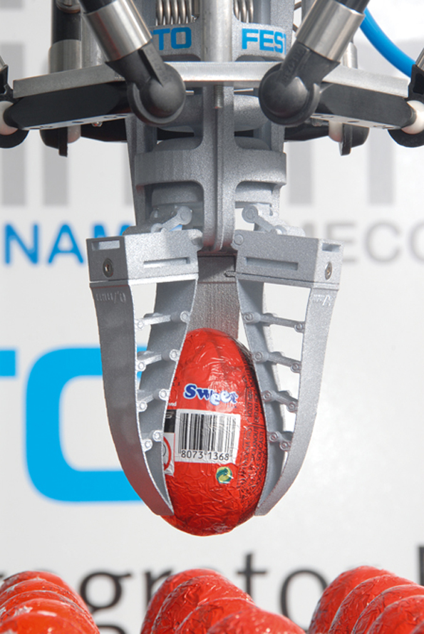

Finally, the FinGripper, with a design based on a fish’s tail fin, is what actually grasps the workpiece. Unlike conventional metal grippers or vacuum handlers, the FinGripper is light, flexible, and readily adapts to an object’s shape, which makes it particularly well suited for fragile and irregularly shaped products. It consists of a pneumatic bellows actuator (or, for longer life, a simple pneumatic cylinder) and three fingers. Compressed air actuates the bellows which, via lever action, opens and closes the fingers
The basic finger consists of two plastic bands which meet at one end to form a triangular structure. Intermediate stays that add strength connect to the bands via articulated joints. This flexible design lets the fingers adapt to the shape of a workpiece when pressure is applied laterally — just like a human hand, but much faster, according to company officials.

The FinGrippers, however, are currently in production and being used on more-conventional robots by nearly 20 customers to quickly and reliably handle fruit and pressure-sensitive food.
For instance, the Dutch company Total Systems, a manufacturer of equipment for handling flowers and bulbs, opted for FinGrippers on a machine that sorts bulbs by size and quality — work that was previously done laboriously and less efficiently by hand.
And attempting to move soft, hollow, chocolate eggs with conventional grippers has, in the past, resulted in a significant amount of damage and waste. On a sorting station with FinGrippers, in contrast, the fingers fully enclose the chocolate eggs without crushing them or damaging the aluminium wrapping. The flexible design even lets the fingers grip eggs that are leaning or improperly positioned.
