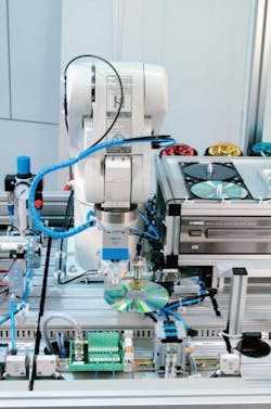

Grippers are available to suit just about any application, such as this parallel design used to handle DVDs.

The majority of grippers are variations of three fundamental designs: Parallel, three-finger, and angled grippers.
Parallel grippers are just what their name implies — two slides either closing parallel to the workpiece to grip its outside edges, or opening out to put pressure on inside walls. Parallel grippers are by far the most commonly applied design.

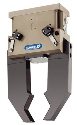

Grippers vary from simple configurations such as two-jaw parallel designs to complex, handlike structures with advanced sensors, control units, and servomotors. To learn more about gripping technology, we turned to Jesse Hayes, automation group manager at Schunk Inc., Morrisville, N.C.
Hayes explains that the two-jaw parallel gripper is the most versatile design and is able to handle a large percentage of applications.
Two-jaw angular grippers can handle myriad part shapes and sizes.
“The reason why the two-jaw parallel design is the most commonly used is because it can handle so many part shapes and sizes. It can also do the same job as the other two basic gripper types, the three-jaw gripper and the two-jaw angular,” says Hayes.

Regarding terminology, the words “jaw” and “finger” are sometimes used interchangeably, as a kind of industry slang. However, Hayes explains that it is actually a gripper's jaw that supports and handles the bearing loads; the finger is a customized piece (made for a specific product) that an end-user bolts on to the jaw.
“Most customers design and machine their own fingers to bolt onto our gripper jaws. But if they need help with finger design and manufacturing, we can do that as well,” says Hayes.

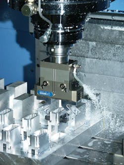

The PGN-plus-two-jaw parallel gripper from SCHUNK finds use in a machine tending application.
Regarding gripper actuation, about 80% of today's grippers are pneumatic. The reason? Grippers are mostly short-stroke components, so they don't consume a lot of air, according to Hayes. “Think about a long-stroke linear actuator,” Hayes says. “This component uses a lot of compressed air along its stroke length, so more of these designs are becoming electric. One day, we may see more servo-electric grippers in use, but today they're roughly two or three times as expensive as pneumatic designs.”
