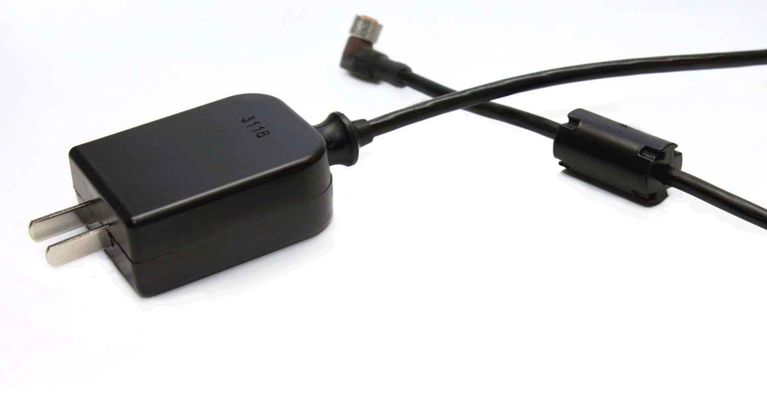

The CF-rated power supply from Bear Power is designed to send dc power to surgical instruments and other medical applications.
The CF-rated power supply from Bear Power is designed to send dc power to surgical instruments and other medical applications. The rugged 9-W AC/DC converter is sealed and encapsulated to withstand wash down and rigorous drop testing. It meets UL60601-1 and UL60601-2 standards for medical equipment. The compact power supply has less than 10 µA leakage current and measures less than 4 cubic inches. It has 120 Vac input and +9.1 Vdc output. Other voltages are available on request. It is designed and made in the USA and can be customized to meet OEM requirements for power, voltage, form factor, number of outputs, and other specifications. OEM pricing is available.
