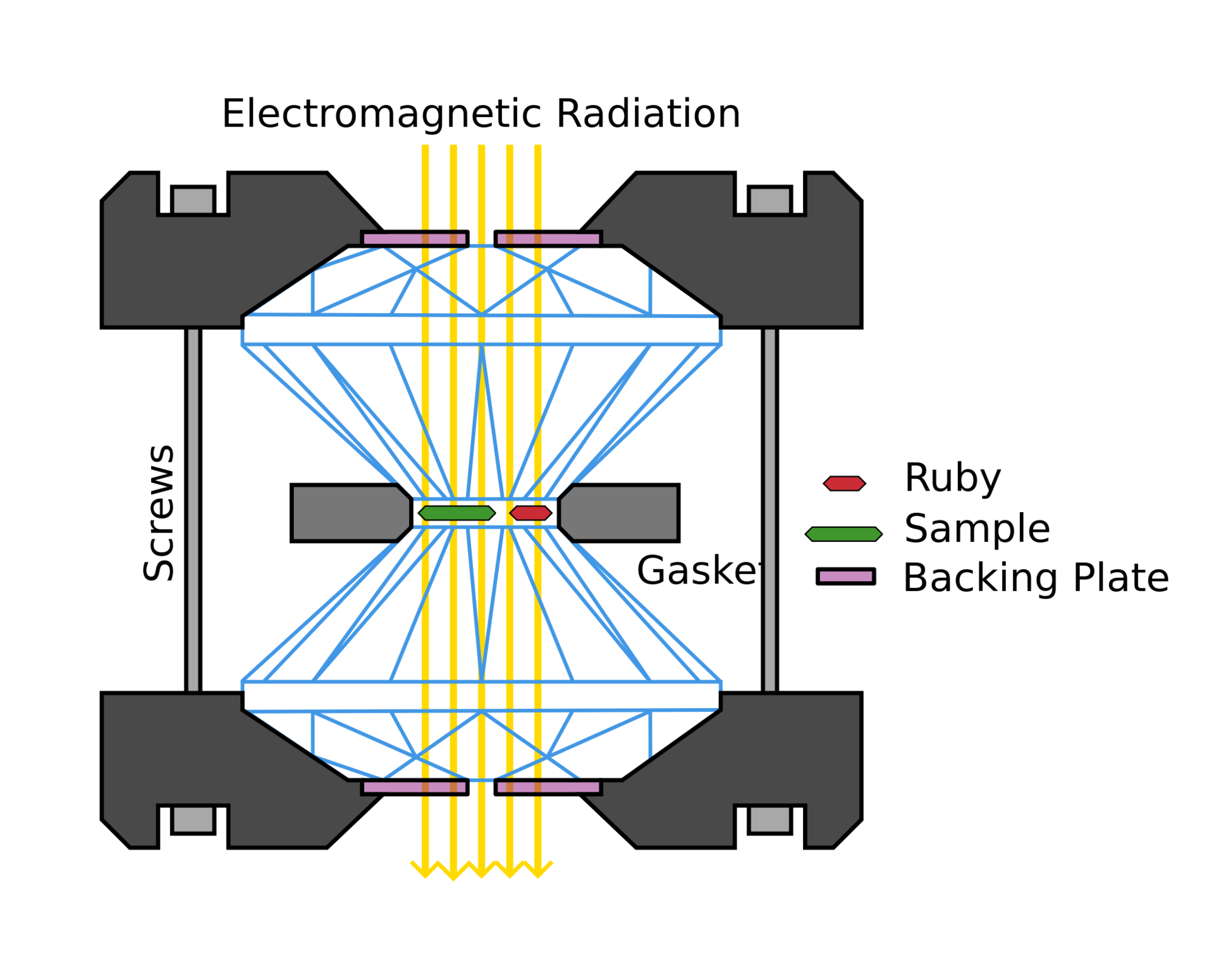

Cell diamond anvils limit the lifetime of these hydrogen phases to less than a second, and only allow a few molecules to be compressed at a time between the tips of diamonds. These limitations have prevented scientists from coining their success for decades. (Courtesy of Wikipedia Commons)
Most often, scientists try to create metallic hydrogen using cell diamond anvils that compress miniscule amounts of hydrogen gas between the tips of high-quality diamonds. Through decades of experimentation, scientists have been able to observe crystallization to some extent, but converting hydrogen, a gaseous insulator, into a metallic conductor of heat and electricity, requires ultra-high pressures that can last long enough to be measured. And since any imperfections in the diamonds can cause them to crack, experiments can be tedious and expensive.
