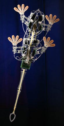

Kim: I was born in Seoul, South Korea, where I attended Yonsei University. I graduated with a bachelor’s in mechanical engineering. Afterwards I attended Stanford University to obtain my master’s degree and my PhD. Stanford is where I started working with bio-robotics for the first time. In 2006, I worked with the Prof. Mark Cutkosky to develop the Stickybot, which won Time Magazine’s Best Invention 2006. Stickybot is a gecko-inspired robot that could climb walls. I invented the directional adhesive that allowed the tiny hairs on the gecko’s feet to cling to the walls. The interaction between the toe hair and the wall is a molecular attraction called “van der Waals force.” This allows the gecko to hang on and support its weight on one toe while placing the other on the surface. I studied a lot about biomechanics and biology and tried to discover design principles to implement in mobile platforms. Afterwards I completed one post-doc year in Harvard at the microrobotics lab. In 2009, I started my assistant professorship at MIT and started working on the MIT Cheetah robot. This past year in 2016 I was awarded tenure at MIT.
The Stickybot is a gecko-inspired robot that can climb walls and glass surfaces via small hairs and adhesives underneath its feet.
