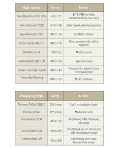

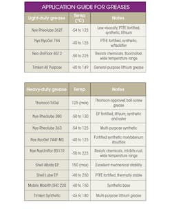

Selecting the Right Grease
Selecting the proper grease is a bit more complex than oil specification. Greases consist of mineral or synthetic oil, additives, and thickening agents such as lithium, bentonite, aluminum, and barium complexes. Some issues to consider are synthetic versus mineral-based, additives, and environmental conditions. Note that speed is not a criterion for grease selection because, unlike oil, it can handle dn values as high as 1,000,000, which is about 10 times higher than dn’s typically found in ball screws.
Synthetic vs. mineral based: Synthetic greases offer performance advantages over mineral-based lubricants. They function over wider temperature ranges, offer greater stability, and retain the viscosity needed for adequate film thickness through a range of operating temperatures, speeds, and loads.
Additives: Special additives improve the ability to resist contaminants and reduce wear in the presence of load and vibration. Other additives reduce friction, decrease noise, and increase load capacity. Avoid greases with graphite or molybdenum disulfide, though, because they reduce friction to the point where it promotes ball skid and interferes with the ball bearings’ rolling process.
Specialty products: Specialty greases, including vacuum and food grade, as well as those for clean rooms or extreme temperatures, should be selected based on performance requirements.
To help engineers sort through the options, the National Lubricating Grease Institute (NLGI) identifies nine grades based on consistency (above). Although the list is not enough to specify which type of grease is right for a particular application, it does provide a useful qualitative measure.
The lower grades are softer and flow better. Higher numbers are firmer, tend to stay in place, and are a good choice when leaks are a concern. Grades 000 to 1 would typically be used in applications requiring low viscous friction. Grades 0, 1, and 2 are used in highly loaded gearing, and grades 1 through 4 are often used in rolling contact bearings, with Grade 2 being the most commonly used in that range.
The chart above gives recommendations on how much grease per circuit to use based on the ball screw’s nominal  diameter. A 25-mm-diameter screw with six circuits, for example, requires 0.4 cm3/circuit, or 2.4 cm3 total.
The table below matches some of the leading grease brands to applications based on the NLGI guidelines and information published by grease or ball-screw manufacturers. While by no means a complete list, it should provide some useful guidance.
