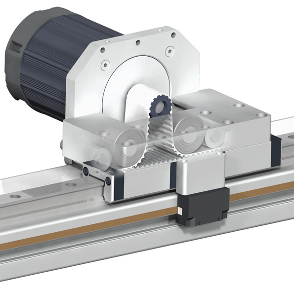

Preengineered stages like this ServoBelt linear actuator typically cost 25 to 50% less than their component-based counterparts, thanks to reduced part counts, especially of brackets and connectors. They also slash costs related to design and maintaining inventories.
Properly preengineered motion subsystems fit within a defined physical space and tie into the machine’s controls. They typically accept commands from a top-level computer interface, control card, or PLC. The simplest preengineered systems consist of little more than an actuator and connectors. Complex preengineered stages add controls and even end effectors to move payloads.
Preengineered stages often outperform component-built systems because they’re customized. In contrast, many machine builders don’t have the skilled technicians, fixtures, and laser interferometers and other equipment to align stages (which often have axis-to-axis alignment tolerances measured in microns).

This preengineered multiaxis stage based on ServoBelt linear actuators is tested prior to adding it to a semiconductor-manufacturing machine. The stage has zero backlash, so the designer can tune the controls to dynamic requirements. That’s helpful because the only way to make fast index moves in this machine is to close the servoloops using the linear encoder, which requires a backlash-free driveline from motor to payload.
In contrast, a preengineered stage based on belt-driven drives is cost effective. It doesn’t need dual-loop control because it can get by with single-loop control using only the linear encoder. The drive also has inherently high mechanical damping, which lets the controls have high tuning gains (to four times the velocity and positional gains) for short settling times. In contrast, linear motors must simulate damping in the servoamplifier electronics, which reduces the possible positional gain.
