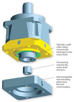

Another consideration is whether to use a separate gearhead assembly or an assembly that is built into the motor. Most motion designs incorporating gearing use separate assemblies. This lets engineers specify the best motor and gearhead for an application, even if they’re from different manufacturers. Typical gearheads can be mounted to just about any servomotor through flanges and standard screws. A splitcollar mechanism on the input gear secures it to the motor shaft. This configuration is more flexible than an integrated gearmotor. In addition, gearheads wear more quickly than motors and, when this happens, it’s only necessary to replace the gearhead and not the motor — which keeps maintenance costs down.
