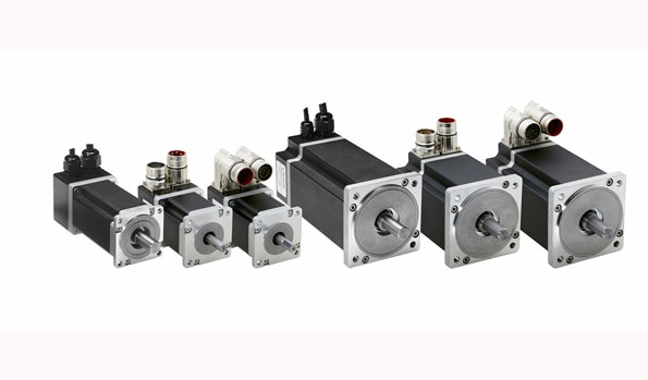

The RapidPower Plus Series of high-torque, high-performance brushless servomotors are designed for higher-precision applications. The low-vibration BLDC motors use M-8 ceramic and rare-earth neodymium magnets, to provide quick acceleration and consistent speed (up to 15,000 rpm). Sealed ball bearings and reduced torque ripple from skewed magetization also ensure a smooth operation at any speed.
The motor’s new, more-rugged construction and TENV enclosure design let it handle challenging environments as well as applications where high speed, accuracy and durability are essential.
The motors come in a variety of windings, shaft configurations, and encoder options.
