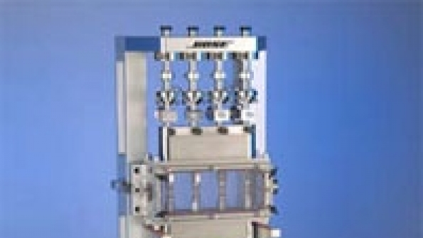

One area where moving-magnet motors are already making an impact is test instruments. The motors are bridging the gap between traditional servo-hydraulic and DMTA technologies. Dynamic mechanical analysis tests are one use; they're conducted on materials from elastomers, plastics, and tissue to gels and emulsions. Properties are measured as a function of changing frequency, temperature, strain, amplitude, mean level, or preconditioning.
Fatigue and fracture studies represent another area where moving-magnet linear motors excel. Mechanical tests like these take advantage of the high frequency response, which accelerates crack growth in materials, for example, as well as the application of millions of fatigue cycles. The flexure makes sure that the damage is directed to the specimens, not the test system's seals and bearings.
Another application is nonlinear material modeling. Most finite element material models require the measurement of force along with the deflection behavior of materials under various conditions. Moving-magnet motor instruments measure cyclic and time-dependent properties of elastomeric materials under realistic conditions. This includes strain levels greater than 100% and frequencies from one cycle per day to 400 cycles per second to simulate the critical conditions for components being modeled. Samples can be tested in simple tension, compression, shear, pure shear (planar tension), and three or four-point bend configurations under single or multi-axial loading — to measure all critical material responses.
Flexure-based moving magnet actuators in testing equipment are designed for high acceleration (more than 1,500 m/sec2), high bandwidth (static to more than 400 Hz), and near-infinite life, for testing beyond 15 billion cycles. These units need only standard electrical power, and are much more efficient than servo-hydraulic test systems.
