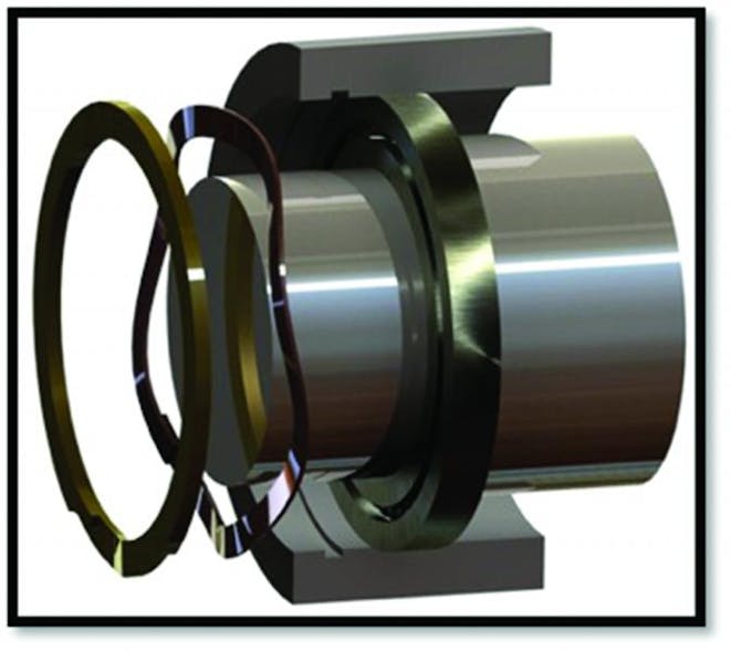

Here, the replacement spiral ring fits into the preexisting groove.

In a typical application, bearings are retained with a single-turn wave spring and endcap.
Traditionally, such bearings are held in place with a combination of an endcap and wave spring. In contrast, substituting a spiral-wound multiple-turn wave spring allows 360° contact with entire periphery of groove, with no gaps — and because there are no lugs, there is a radial space savings.
Coiled versions also eliminate sharp edges, useful in certain designs.
In fact, by replacing the endcap with a multiple-turn spiral ring, the final application is streamlined while still accommodating the bearing's axial loads and high rpm. The shoulder is effectively created with minimal material and space.
Below, a closeup of the final installation is shown without the endcap. In steel or exotic alloys, the rings sport oil dip, black oxide, cadmium plating, passivation, or zinc phosphate finishes.
