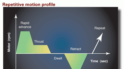

The Electro-Craft Handbook lists the first step in this sizing process: Accurately specify the dynamic motion profile to ensure that the motor won't overheat when executing the required motion profile (see Fig. 1) along with the total ambient condition — ambient temperature, heat sinks, forced cooling — in which the motor operates.
Next, along with motor engineering specifications, we must determine the peak torque and velocity required of the motor during the most demanding portions of the dynamic motion profile. (Again see Fig. 1.) This peak operation point is then entered onto the motor's combined intermittent and continuous torque-speed curves as shown in Fig. 2.
Finally, using the two-parameter thermal model in combination with a time-averaged power dissipation technique, we calculate the root-mean-square (RMS) torque and velocity for the entire motion profile — and then enter this RMS operation point into the combined torque-speed curves of Fig. 2.

As shown in Fig. 1, sizing and selecting the optimum motor for an application begins by defining the dynamic motion profile, along with the total ambient condition in which the motor will operate. Next, using the two-parameter thermal model in combination with the time averaged power dissipation technique, a candidate motor's RMS operation point is determined and entered onto its continuous torque-speed curve as shown in Fig. 2. If this RMS operation point lies outside the boundary of the continuous torque-speed curve, then this particular motor-drive combination will overheat and cannot be used unless the motion profile is modified (or the ambient condition is changed.)
