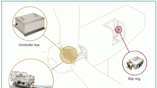

One reason EHA is so interesting, and an advantage over EMA, is the lack of mechanical screws, or gearing. EHA uses an accumulator similar to EH to put a wind turbine's blades into failsafe mode. The accumulator is in the wind turbine's hub with the actuator, so there's no need for a battery to run the servomotor into failsafe. Unlike EH, EHA technology makes use of a servomotor pump package that is linked to the actuator and self-contained, so there's no rotary coupling. A disadvantage to EHA is installation because the assembly is a little larger than EMA.
Switching to EHA: Wind turbine application
Let's assume a wind-turbine manufacturer wants to employ a system that controls blade pitch angle to optimize power generation. Switching from classic hydraulics to EHA increases energy efficiency because the pitch control system's motor turns only when the inclination, or pitch, of the wind turbine blade needs to change its angle. Reliability is also improved, as EHA enables a wind-turbine maker to replace a rotary fluid slip ring and accompanying hoses with an electro-optical slip-ring assembly, thereby ensuring the transfer of electrical power and signals across a rotary interface.
Another benefit of EHA technology is that the self-contained actuator acts as a smart system by adjusting the angle of the wind turbine's blades with internally integrated motion controls and diagnostics. Size and weight are also minimized, because electrohydrostatic actuation allows a wind-turbine manufacturer to remove the large hydraulic power unit (HPU) typically located high off the ground in the turbine's nacelle, reducing weight by up to 40%. Environmental impact is reduced as well, as the removal of the rotary fluid slip ring located in the wind turbine's nacelle eliminates leak points found in the slip ring, hoses, and fittings. A final benefit involves energy storage and reuse: Emergency pitch brake accumulators, located in the wind turbine's hub with blade pitch control actuators, provide emergency fail-safe pitch adjustment in case of power failure.
