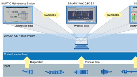

Where to start? It makes the most sense to begin by optimizing drive systems, as they represent the majority of power costs. Here, energy management software can monitor coordinated components and acquire detailed energy-usage data to help engineers formulate energy-saving followup plans.
Visualizing energy-saving potential
The basic prerequisite is to acquire all relevant data; in many cases, this can be done using technology already in place. Automation products such as circuit breakers and frequency converters automatically track current and voltage.
Additional data can be acquired via dedicated energy-measuring devices, often integrated into industrial communication networks such as Profibus or Profinet. Linked to the electrical network, they precisely measure voltage, current, and frequency, and then pass the information to the automation network and HMIs like any other process data.
Enter the energy-management software: By making collected information transparent, it allows engineers to identify machines that use a lot of energy. Usage data is displayed in operating and visualization interfaces and saved in long-term archives. Automatic allocation to cost centers allows identification of hidden energy-saving potential by comparing usage profiles and associated costs. Energy flows can also be evaluated: The software’s analysis makes it clear where changing process behaviors or components to other methods or designs can reduce energy costs.
