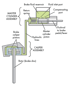

Before we dive into the difference between car brakes, let’s describe the hydraulics behind braking. The hydraulic brake circuit consists of a fluid-filled master cylinder, which connects to a separate slave cylinder. The brake pedal connects to the master cylinder and when pushed, depresses the piston in the master cylinder, forcing fluid along connected pipes. The fluid reaches the slave cylinders at each wheel, which in turn forces the piston to apply the brakes.
The surface area of the combined slave pistons, where the brake-pedal force is applied, is greater than that of the master-cylinder piston. Hence, the master piston has to travel a greater distance to move the slave pistons compared to the fraction of distance required by the slave pistons to apply the brakes. This setup allows for the exertion of a large force by the brakes, comparable to how a long-handled lever can lift a heavy object a short distance.
The hydraulic system used during braking delivers hydraulic fluid from the reservoir to the brake caliper pistons to slow down and stop the brake disc.
In most modern cars, the master cylinders use twin hydraulic circuits in tandem for redundancy purposes. The circuits can be arranged to control different pairings of breaks: one circuit for the front pair and the other for the back pair; or one circuit for one in front and one in back, and the other circuit for the other side.
