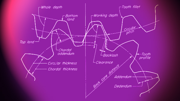

When designing gears, what are the essential terms and nomenclature that one should know?
Prior to beginning designing gears, it is a must to understand how gearings operate—that is, how the gear and the pinion tooth flanks are engaged in mesh, and how they are able to transmit a rotation smoothly (with a constant angular velocity ratio). This problem, which (from the first glimpse) looks like a simple one, is not correctly understood by the most of gear experts—both from industry as well as from academia.
A few of the essential terms include:
Gear ratio: The number of teeth on the gear divided by the number of teeth on its mating pinion.
Operating pitch diameters: The pitch diameters determined from the number of teeth and the center distance at which gears operate.
Base pitch: The circular pitch in the plane of rotation at the base circle.
Pitch cones: The imaginary surface forming a plane (pitch plane) or a cylinder (pitch cylinder).
Center distance: Equal to the sum of the pitch diameter of the pinion and the pitch diameter divided by two.
Circular pitch: The circular distance from a point on one gear tooth to a like point on the next tooth, taken along the pitch circle. Two gears must have the same circular pitch to mesh with each other. As they mesh, their circles will be tangent to one another.
Diametral pitch (or module): A measure of tooth size in the English system. In units, it is the number of teeth per inch of pitch diameter. An increase in tooth size decreases the diametral pitch. Diametral pitches usually range from 25 to 1.
Profile angle (pressure angle): The slope of the gear tooth at the pitch-circle position. If the pressure angle is 0 deg., the tooth is parallel to the axis of the gear—and is really a spur-gear tooth.
Helix angle: The inclination of the tooth in a lengthwise direction. For example, if the helix angle is 0 deg., the tooth is parallel to the axis of the gear—and is really a spur-gear tooth.

The most common gear types include spur gears, helical gears, internal gears, and bevel gears. Below are the basic equations used for each gear to determine the circular pitch, pitch angles, and pitch diameters.
Spur gears
Spur-gear and rack terminology: Spur gears, which are the most common type of gear used, have their teeth on the outside of a cylinder. The teeth are parallel to the axis of the cylinder.
Helical gears
Helical-gear and rack terminology: Helical teeth cut on a spiral that wraps around a cylinder. They progressively enter the meshing zone and in turn have a smoother action than spur gear teeth. They also tend to be quieter.
Internal gears
Internal-gear and rack terminology: Internal gears have their teeth on the inside of a cylinder. The teeth may be made either spur or helical. Internal gears are generally more efficient due to the fact that the sliding velocity along the profile is lower than that of a similar external set.
Straight bevel gears
Bevel-gear and rack terminology: There are four basic types of bevel gears—straight, Zerol, spiral, and skew tooth. Bevel gears impose both thrust and radial loads in addition to the transmitted tangential forces on their support bearings. By convention, the direction of rotation of a bevel gear is viewed from the heel end of the gear looking toward the apex, whether it be clockwise or counterclockwise.
