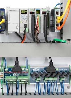

Specify any control application, and it is likely that the PAC would be a suitable controller. With simple data logging, the PAC allows access to the data within the controller to optimize the factory.
With large I/O counts, expanded memory, and enhanced data collection capabilities-the PAC is a fit for a very wide range of applications (see Figure 3). The capabilities setting the PAC apart from the PLC and placing it on an IPC level are coordinated motion and integrated vision capabilities.
The PAC often can handle multi-axis motion control and dual axes or higher levels of coordinated motion. Some can perform circular interpolation if needed and control eight or more axes of motion. The high-speed communication in the PAC also allows it to communicate well with today's smart vision sensors to pass real-time data back and forth. This also enables the implementation of vision-guided motion functions within a PAC.
