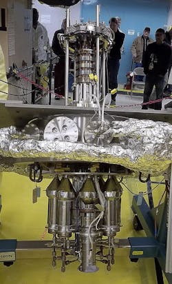

NASA and National Nuclear Security Administration (NNSA) engineers lower the wall of the vacuum chamber around the KRUSTY system at the Nevada National Security Site (NNSS).

The KRUSTY nuclear powerplant is turned upside down during core assembly at the Nevada National Security Site (NNSS).

The prototype power system uses a solid, cast uranium-235 reactor core, about the size of a paper towel roll. Passive sodium heat pipes transfer reactor heat to high-efficiency Stirling engines, which convert the heat to electricity.
