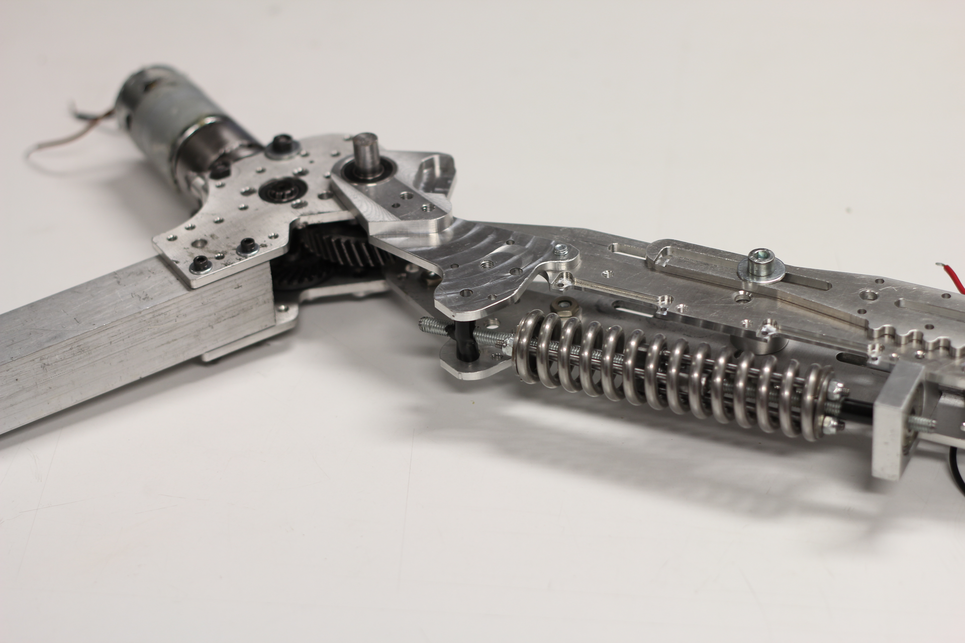

This SEA variation uses one motor (off to the right) to articulate the joint and another (background) to tension the spring. A robot with this type of SEA in its joints can respond to loads with a wide range of force. Called a MACCEPA, the actuator was developed by the Robotics
SEAs make for relatively cheap robotics by putting a spring after the geartrain and adding simple feedback controlling the spring’s amount of deflection. So for the low added cost of incorporating a spring, SEAs get high-fidelity force actuation, even if they’re built with inexpensive motors and gears.
