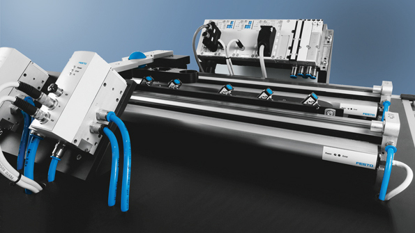

A basic servopneumatic system consists of an actuator with integrated feedback (encoder/potentiometer or other position-sensing element), a proportional valve, and a controller.
What differentiates these systems from standard pneumatics is that servopneumatics uses closed-loop positioning which, therefore, lets them perform like conventional electric servosystems.
Festo’s high-flow VPWP proportional valves permit servosystem travel speeds to 3 m/sec.
In addition to the valve being proportional, a requirement for position and speed control, built-in sensors provide feedback on the pressure and, therefore, force. This permits force control.
The controller uses sophisticated, tried-and-tested algorithms that take into account variations in valve linearity, actuator orientation and friction, and the compressibility of air to provide accurate positioning and force control. For example, Festo servopneumatic systems offer positioning accuracies on the order of ±0.2 mm.
A wide range of actuator speeds and output forces is also possible. The flow rate of Festo’s VPWP 5/3 way proportional valve, for instance, ranges from 350 to 2,000 lpm. This is on par with the company’s other valves. It lets servosystems move horizontal loads of up to 1,300 kg and vertical loads to 1,100 kg. Travel speeds can reach 3 m/sec with maximum acceleration of 30 m/sec2.

Standard, ISO 15552 rod-type cylinders in bore sizes from 32 to 100 mm and stroke lengths from 100 to 750 mm. Maximum controlled force is 4,200 N. They come with a contactless displacement encoder for incremental measurement, as well as optional guides and clamping units.
Rodless linear drives with recirculating ball-bearing guides, in bores ranging from 18 to 63 mm and strokes from 100 to 2,000 mm. Maximum controlled force is 1,680 N. They’re well suited for handling and assembly applications, and are available with optional clamping units and food-grade lubrication.
Semi-rotary drives in diameters of 25, 40, and 63 mm with swivel angles from 0 to 270°. The compact units have a built-in rotary encoder and offer mass moments of inertia up to 6,000 kg/cm2.
