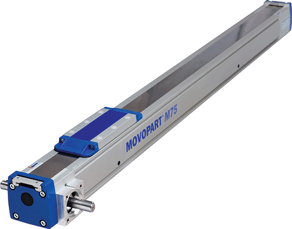

Belt drives are a good choice when moving loads linearly distances of 16 ft or less. They are mechanically straightforward. They use pulley drives to generate tension along a belt, which can quickly be brought up to speeds of 33 ft/sec. However, the longer the stroke, the more likely the belt will sag as it cannot maintain tension along its entire length. Plastic or rubber belts commonly used also have a lot of inherent give, which affects the drive’s accuracy. This flexibility can also cause vibrations or springing in the belt, which creates a whipping effect for the carriage and degrades the drive’s precision even more.
Belt drives, such as this Movopart actuator from Thomson Industries, move items atop the saddle or carriage attached to the belt. They work fine for movements of up to 16 ft, but stretch and lose too much accuracy above that.
