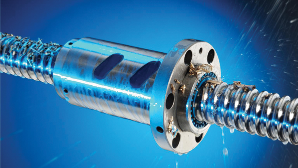

Ball screws in machine tools can be exposed to a wide variety of unexpected contaminants, most of which shorten their operational lives.
From this equation, an engineer might conclude that either reducing Fm or increasing the load rating by using a larger unit should increase a bearing’s useful life. This would be a valid conclusion for conventional, slower-turning bearings. Modern machinery moves much faster, a regime where abrasion and adhesion, factors left out of the classic L10 equation, become more important.
Abrasive wear is caused by contamination inside the ball-screw nut. Adhesive wear stems from microwelding — a result of the lubricant-film breakdown. The effect of these wear factors is premature failure from loss of preload. Because advanced servodrives are sensitive to changes in friction, avoiding preload loss becomes critical.
Therefore, to extend the life of ball screws, cleanliness and lubrication to reduce abrasion and adhesion must be considered, as well as dynamic-load capacity.

It is normally not possible to cover or house ball screws tightly enough to completely keep out contaminants such as dust and finer particles. In many cases, wipers seal nuts from abrasive particles. Regular, noncontacting wipers (labyrinth seals) will not keep out small particles because they inherently have a gap of several tenths of a millimeter between the seal and shaft. Brush wipers are also ineffective in keeping out contaminants.
Lip seals made of elastic materials are substantially better. Like shaft seals, they provide a tight fit. But because these seals typically include a lip that must slide against the screw with considerable pressure to ensure a tight seal, it causes high friction and wear. And in large-pitch ball screws, the lip seals may flex axially, compromising their effectiveness.
Plastic wiper “fingers” should precisely fit into the surface of the screw thread to clean them prior to passing through the ball screw. Note the spring used to preload or tension them against the screw threads.
Currently, the best solution is segmented plastic wipers with several edges oriented at approximately right angles to the direction of motion. The wipers mount on both ends of the nut and must fit closely because their effectiveness depends largely on their line of contact with the screw. Segments must be stiff enough to remove tough dirt from the screw but remain flexible enough to stay in contact despite the spring preload.
When specifying segmented wipers, ensure that wipers with protruding “fingers” do not contact the elastic end of travel bumpers. In such cases, flush mounted wipers are necessary. Wedge-shaped segments or beveled edges are best when large amounts of dirt are present.
