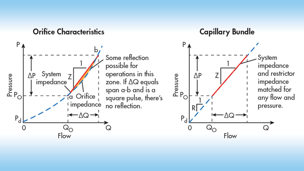

A simpler, passive method of controlling pressure transients in hydraulic sustems can be accomplished using line restrictors.
These graphs compare the pressure/flow characteristics of orifice and capillary restrictors. The characteristic impedance of an orifice restrictor does not vary linearly, so it will not always match the system impedance. Therefore some reflections are possible under certain operating conditions. Capillary restrictors, however, have linear characteristic impedances, so they can be sized to match a system’s impedance for any combination of flow and pressure.

When the pressure pulse and its concurrent flow pulse hits the flow restrictor, the pulse is reflected unless the restrictor passes exactly the same ΔQ for the arriving ΔP wave. In severe cases of deflection, the pressure pulse can nearly double in magnitude. Reflections can be so severe that they cause local cavitation in the lines and near the ports of hydraulic components and cause damage. The object of transient control, therefore, is to make the pulse leave the line via the restrictor with no reflection.

Typically, one orifice can absorb or damp only one specific pressure pulse level, limiting the practicality f orifice restrictors. Normally, they are used in pairs—one at each end of a pipeline—to damp transients in the system operating at two clearly defined flow rates.

Comparing the first equation to the last one gives the condition that Z for zero reflections, which implies the results are independent of flow variables. Thus, a capillary restrictor is sized only for fluid and pipe characteristics and is not affected by pressure level or flow. As result, capillary restrictors are more universally applicable than orifices, although they may cause large pressure drops at high flow rates.
