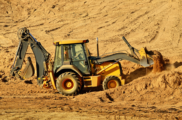

Electronically controlled, open-circuit pumps are often used where hydraulics must power more than one operation on the same machine, such as a backhoe with a loader on one side and excavator on the other.
This potentially reduces size and weight while permitting smoother motion with higher precision and repeatability. Electronic controls also lead to higher operating efficiencies and usually offer better value than standard load-sense controls. For all these reasons, electronic pump controls are gaining rapid acceptance among OEMs and users.
