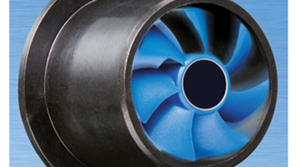

The plain bearing has many names; often engineers will use plain, journal, sleeve, bushing, and slide bearings interchangeably. These types of bearings can be as simple as a tube of relatively soft material pressed into a hole as a guidepost, or used as a caster bearing (a metal sleeve with a wheel or ball inserted).
Sleeve-type bearings, which typically work in a rotating or sliding shaft application, are commonly known for linear motion almost as much as rotary motion, according to Thomasnet.com, a product sourcing and supplier platform. These bearings come in two types: a cylinder that mounts flush and only handles rotary loads, and a “flanged bearing” that helps a flange with axial loads.
Processing will affect cost and must be considered during bearing selection. A flange may not sound complex, but it changes processing and therefore will affect cost. This is a benefit for different materials. Plastic, for example, can be relatively easy to process.
Simply adding a feature, such as a flange, to your design can inflate cost. However, not adding a needed feature could lead to failure. That said, the first step to pinpointing the right plain bearing is to evaluate how and where it’s used.

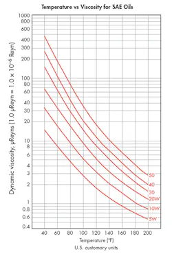

Petroleum oils are often designed to operate around, or under, 160˚F to combat oxidation. However, one of the biggest reasons for temperature control of lubricants concerns viscosity. Dynamic viscosity is imperative to bearing performance, and it changes with temperature. Viscosity is expressed in lb*s/in.2 (knows as a Reyn, named after Osborne Reynold for his significant work in fluid flow) or Pa*s in SI units. Some engineers will express it in centipoise.
1.0 lb*s/in2 = 6895 Pa*s
1.0 Pa*s = 1000 centipoise
