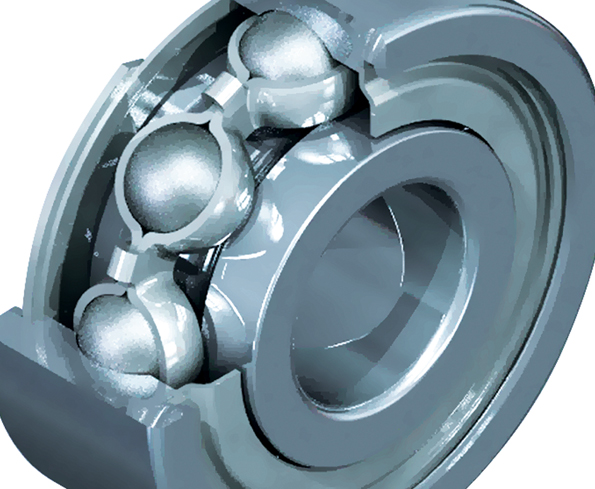

Cross-sectional view detailing the components in a typical bearing.
However, in the case of extreme or harsh environments, the basic rating life is adjusted downward as conditions dictate. In some cases, the life adjustment factor is as low 0.1. This means that, because of environmental conditions, only 10% of the calculated rating life can be assumed.
