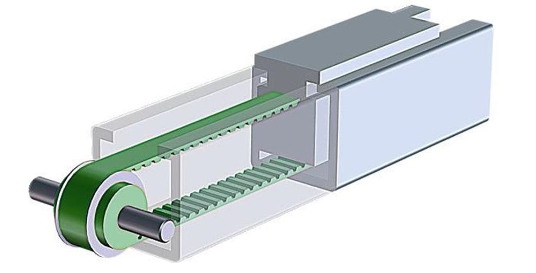

Belt Drives
Belt drives translate motion using a belt looped around a rotating drive pulley connected to the motor shaft and an external pulley located away from the motor. When the motor rotates, the belt moves in the direction of the rotation while tensioning mechanisms sustain contact with both pulleys. This carries the load much like the rolling pulleys of a conveyor belt move its contents in a linear path.
The belt can use a toothed gripping mechanism (Figure 3) or a wide variety of plastic, rubber, leather or other materials capable of gripping and driving the load.
Belt drives offer design flexibility by enabling longer strokes, greater control over speed and direction, and the ability to absorb shock and vibration. Belt drives can also be cost-effective for high-throughput and high-speed transport because their sliding surface traction does not degrade significantly at high speeds. Belt drives are especially adept at accommodating dynamic changes in speed and direction.
Slippage is one drawback of belt drive technology. Heat, dust, chemical exposure and other wear can loosen the belt, reducing efficiency and increasing failure risk. To address this, vendors might provide idler pulleys or adjustable tensioners that maintain proper tension in the belt automatically, preventing slippage and reducing the frequency of belt replacement.
