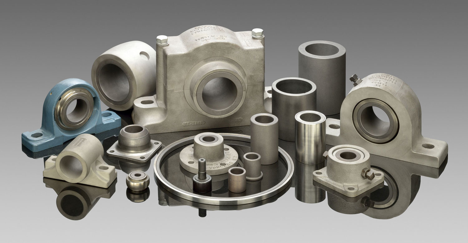

Graphalloy bearings and bushings are available as flanged bushings, thrust washers, and pillow blocks. Compression strength ranges from 15,000 to 25,000 psi, depending on grade. The bearings are nearly inert and mostly impervious to industrial processing fluids such as petrochemicals, pulp and paper mill liquor, food compounds (some are FDA-acceptable), acids, steam, and certain corrosive gases. Applications include kilns, furnace conveyors, dryer rollers, steady bearings, boiler feed systems, and petrochemical pumps.
